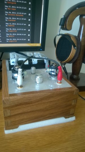

Hi all, I have some leftover OCC silver plated 20AWG cable and I was wandering if using this instead of the standard cables(including the battery ones) would make a difference in the sound.
As for my quickie mods I swapped the power caps with Axon true caps 75uf and the output caps with MR ClarityCap 630V 2.7uf. PJCCS is installed.
Standard volume pot was changed with an ALPS one and I am using Telefunken DL92. I like them more then all my other ones.
To the base of the wood case I added some thick foam to stop the microfonics and and added tube dampers as well.
What this does is it adds that special something to the sound but I want to take the quickie all the way if possible.

I wouldn't replace the DC wiring. But the signal wire is worth upgrading. That is from the input RCAs to the switch, to the volume control, into the tube and out of the tube to the output RCAs. That last run is probably all a capacitor.

Well I changed signal wires and made some interconnects with the leftover occ cable to replace the cheap ones. I did not expect any significant changes but my God it sounds good. Everything is clearer more dynamic, bass goes deeper and seems more refined. This takes my LCD-3F to the next level.
