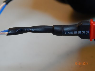

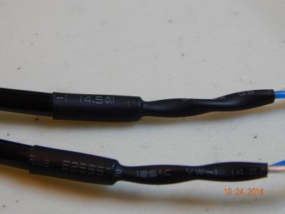

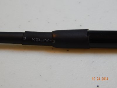

I used 8mm 2 conductor cable pants.
The heat shrink that I used at the cable and cable pants joint was 12 mm.
The heat shrink I used at the cable pants to blue/white wires for each channel was 4.5 mm.
The heat shrink I used at the cardas connector was 9 mm over the larger part then covered with 4.5 mm to finish the joint to the blue/white wires.
I chose to leave the cable "naked" and not use techflex.  I didn't want to use anything that was not necessary and that may add noise as the cable rubs against your clothes, etc.  I like to keep things simple.
Here are some more detailed pictures that may help.
Adrian C.
