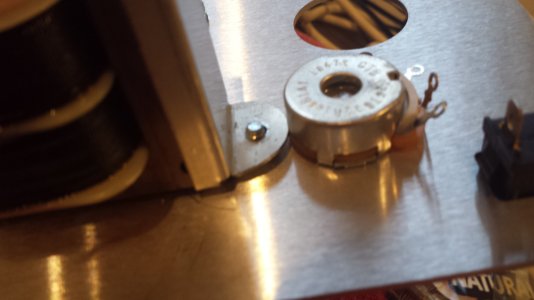

  • The screw hole for the PC-2 is hitting the hum potentiometer, as seen in the attached pc-2.jpg.  I'm just planning to bend this a bit, but wanted to post this photo so that the bottlehead team can make a note of it for any future products.

The picture of the choke looks like it may not quite be aligned, since the nuts aren't in place. If it doesn't seem like it will snap into place when secured, you can carefully trim the flange with tin snips or file it to give more clearance.

As far as the hum pot goes, we ended up changing parts somewhere along the way.  There isn't much harm in those two touching, but if you have a file laying around, you can file that choke mounting tab to add some clearance.
