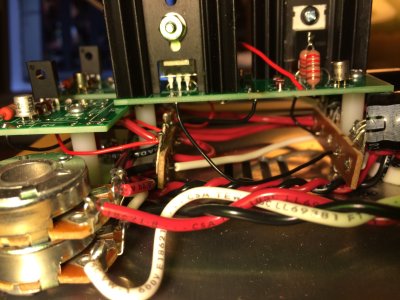

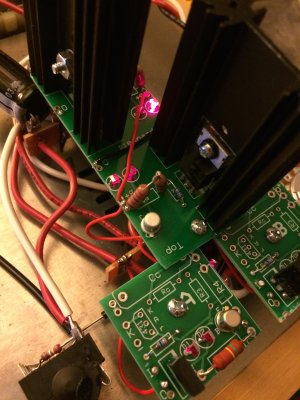

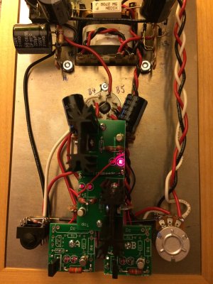

Hey all, last night I finished the speedball upgrade after a few weeks with the stock crack working flawlessly. I have triple checked that all the connections are in the right places, however when I turned it on all of the leds lit up dimly, EXCEPT THE D2 ON BOARD B AND THE INNER LED ON THE HEATSINK BOARD NEAREST THE POWER SUPPLY.

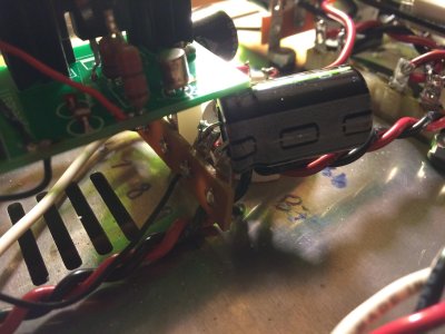

The capacitor, (or something under it) in terminals 14 and 15 got very hot and let out a wisp on smoke. I quickly turned it off. So tonight I turned it on again and the same one or two leds turned on, (both tubes glowed fine), so I left it on for about 3-4 minutes, and watched the area of the capacitor. It started to smoke again so I switched off. It was hot again I could feel it with my hand hovering over it.
At one point before I had installed any of the speedball, I dropped the crack on the workbench, only from about 3 inches but maybe the bump against the table top may have damaged something.
Also there wasnt much slack on the leads of the two capacitors that needed to be bent down to allow the pcb board to sit properly, so when I bent them down, the posts they were connected to also bent quite a bit. Hopefully the photo illustrates this ok. Thanks, please have a loot at the photos.

Just thought i'd add that in the photos it doesn't look like any of the leds except one light up but i turned the lights off and all were glowing except two that I mentioned in the previous post.

This kind of issue is almost always an issue with installation of the insulators on the TIP-50 transistors.
You can confirm this by running the Crack without the 6080 installed, then measure the voltages on terminals 1, 2, 4, and 5.
If terminals 2 and 4 measure above 150V DC, you won't be smoking the power supply.
If you pull the 6080 and there's still an overheating issue in the power supply, let us know.
I can't quite tell in your photos, but it looks like one of the shoulder washers on one of the TIP50 mounting kits may be in backwards.  They are intended to keep the body of the screw from touching the heatsink.

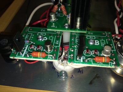

Reply #7 on: September 29, 2014, 01:40:46 PM
Remove the 2N2222 from the side giving you 210V on T5 and swap it for the 2N2907 that must mistakenly be installed on the big PC board.  (didn't notice this until now)
Test again first with just the 12AU7, then test with the 6080.  It is possible that you will need to replace some transistors if the voltages don't come out properly.

Reply #9 on: September 29, 2014, 02:52:51 PM
Yes, except for the writing.  2N2907's go on the little boards, 2N2222's go on the big boards.
