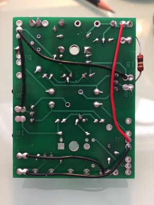

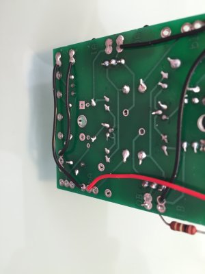

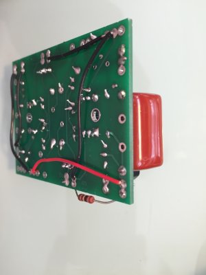

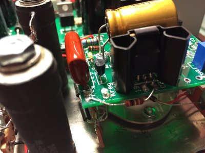

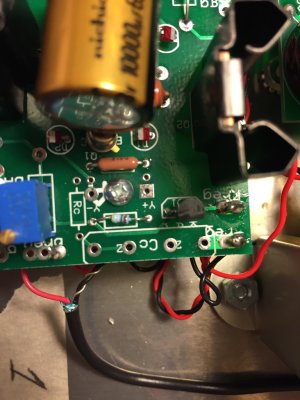

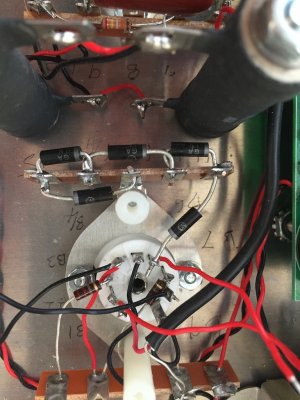

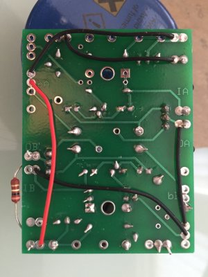

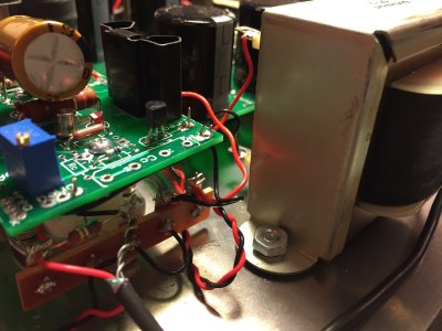

I have attached pictures of the driver board and the 9 pin socket underneath. For reference I am measuring kregB from the kreg label in the bottom left of image 'Driver Board 1' and kregA to the immediate right of the heatsink in the top right of the image.
kregB connecting to B8
OB connecting to B4
-kreg (A side) connecting to T17U
IA connecting to T16U
Kreg (A side) to B2
OA to B6
Many thanks,
Bill

Reply #3 on: October 18, 2014, 08:11:29 AM
For the sake of completeness, I'd swap 5670's to be sure that the weird voltages don't follow a tube.
    • Posts: 5907
Reply #4 on: October 18, 2014, 10:31:05 AM
Nice, careful documentation - it's a big help, thanks!
Assuming that swapping the 5670 made no difference, here's what I see so far:

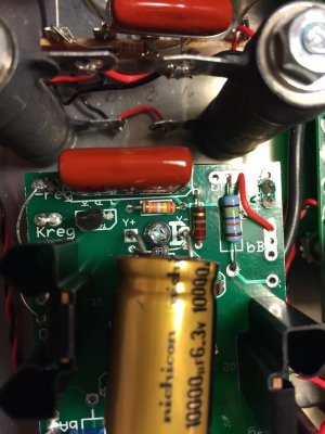

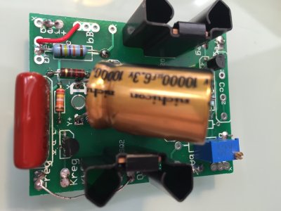

The low voltage at OA indicates the regulator output is far too low, and the low voltage at kreg on the B side indicates that's because the 431 is saturated.

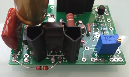

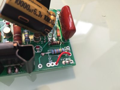

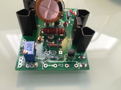

I can't get a good look at the B side 431 and its associated R3 (2.49K). From the back side I can't see that there is anything in the 431 holes at all, but it may be just a trick of the light. Anyhow that 431 and associated 2.49K R3 are the places I'd look first. If the R3 is not connected, or the wrong value. If you put the 4.99K resistor in there (instead of in the A side R3, where it belongs) you would get a regulated voltage of 150v, which is what you have - but I'm not ruling out coincidence yet!
Offline Horatio
    • Posts: 67
Reply #5 on: October 18, 2014, 11:31:13 AM

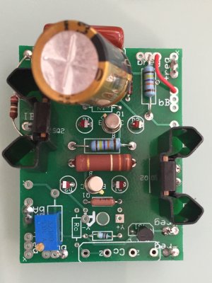

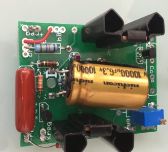

Paul, thanks for the help... I think the resistors are in the correct holes... I have attached a few more pictures to show those areas of the board more clearly. I will re-do the solder joints in the morning (taking snaps of the front and back) and will check the 5670 at the same time. I am currently waiting on more solder being delivered - what a time to run out!!!
Bill

Ok, solder arrived so I have taken off the driver board, heated every solder point on the back, touched up any on the top that looked like it could do with some more contact. Reattached and got exactly the same readings as before.
Assume this rules out any issue with a specific 5670 as the same issue is showing on both...

Reply #7 on: October 19, 2014, 08:59:51 AM
I see 249K resistors on the board where 2.49K resistors should be.  Check your color codes and parts between amps.

    • Posts: 5907
Reply #11 on: October 19, 2014, 11:50:19 AM
That was exactly the reason I kept asking for pictures that showed that resistor and the associated 431.
So, the 431 was saturated and the 150 volts being half of the target 300 volts was just a coincidence.
Re "... I think the resistors are in the correct holes..." - yeah we've all been there; I get reflexively suspicious whenever I hear myself saying that. Which I do, all too often! When in doubt, check. Still in doubt, check again. Absolutely certain, get someone else to check for you.
