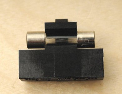

You can check your fuse to see if it is blown by setting your meter to the lowest resistance range and putting one probe on each end. You should read less than 1Ω if the fuse is good. Also a common mistake is to put the fuse in the portion of the holder meant to keep a spare fuse, rather than the part that actually puts it into use. See the pic attached.
