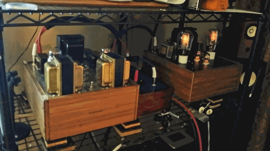

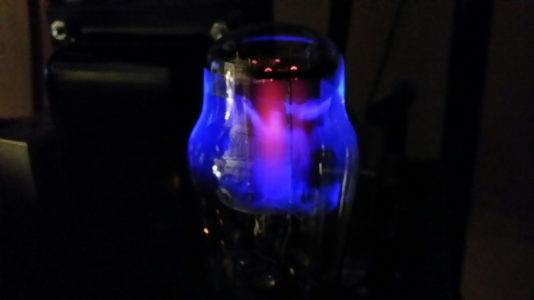

Just a quick question, had the amp playing in the den while the baseball game was on.  2A3 SET, basically 2 paramours in the same chassis.  Came in to shut it down while we go party and saw this tube glow.  Lots of blue and RED.  Never saw red before.  Took a pic and shut it down.  Long night of celebrating ahead, what should I look for when I get the chance to check on the amp tomorrow?  It was playing music fine.  Chassis and power transformer very hot.

Hard to tell from the picture, but if the red is from the plate then you are drawing too much current, most likely a grid bias failure but possibly a tube failure.
The blue appears to come from the glass, not the vacuum - again this is really hard to tell from the picture. The glass will glow when it is hit by lots of electrons, which is consistent with too much current but would not be a problem of itself.

Looked at the amp this morning before work.  Swapped tubes to test for a failing tube.  The blue glow is from the glass, the red is the plate, definitely the plate glowing.  Tube filaments come on, then the blue starts and flickers, then the plate starts to glow.

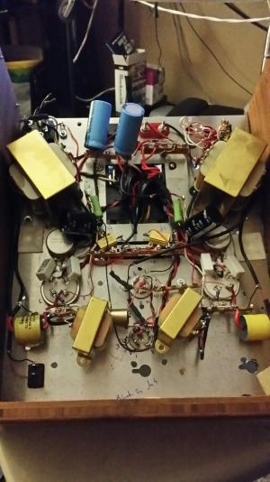

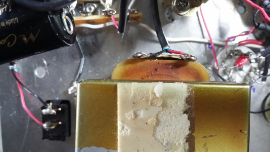

Shut the amp down and flipped it over for a quick visual.  I f'd something up royally.  There's heat damage visible on the power supply chokes (can't even read the C-7x on the paper anymore, it's all brown) and on the plate chokes (can't see Mike's writing, looks like varnish has run and looking down at the bobbin (?), it's not light yellow anymore, I can see brown thru it).  I'm surprised I didn't smell anything before.
No other visible damage, fuse never blew, resistors, outputs and grid chokes all look fine.
Looks like it was overcurrent on both channels and one tube finally gave me indication.  I'll email Mike to see how much of a beating the BH-6's can take and put in a order for new if needed.

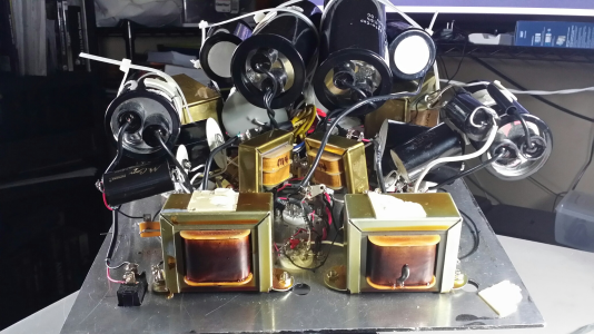

I know it's a mess, didn't start out that way but it is what it is now.  I took out one pair of bypass oil caps, that made it a little easier to get around to things.

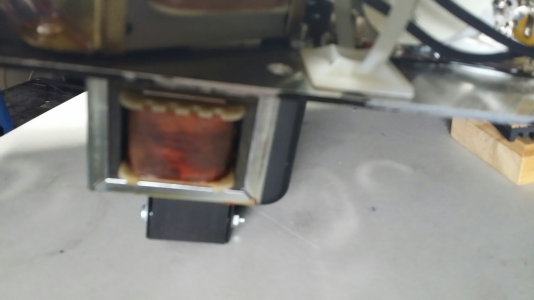

Measured the damaged parts and others noted as possible failure points.
Plate choke left  125 ohms, right 510 ohms
grid cap left  98nf, right 90nf
both grid chokes read OL
Found a loose connection at the left power supply choke that got touched up.  Gathered up the replacement parts (parafeed cap, resistors, etc)

If the grid chokes are open like they measure that could be the issue. IIRC the DCR should be maybe around 4K ohms. And you will need to determine if that choke that measures 510 ohms is cooked or if there is just a bad solder connection that is running the resistance up.

I can't figure a scenario that would blow out the grid chokes, but I agree that if they are truly open-circuited that would lead to excessive current.
510 ohms is about right (spec is 550) for a BH-6. It's the other one that appears to have an internal short.
Mike usually uses a special wax impregnant, which is probably what's leaking out.
