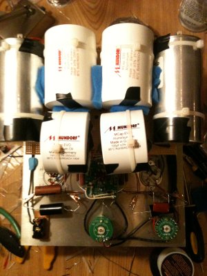

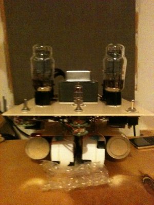

I mostly finished my stereomour yesterday evening. I have to make a base still, but I have tunes! I broke a film cap lead so I put the stock one in for now. I did get a couple extra cap values to try in the output (2.2, 3.3 stock, 4.7). Man I am so happy! This is so great BH! I'll post a better photo next time I'm just stoked so wanted to give some feedback. It sounds very good and it makes me happy. That's the goal . No point in trying to add much to that for now.

Reply #1 on: November 03, 2014, 04:36:02 AM
I was going to say that it wouldn't fit in the base but you know that.
Nice group of caps there.  And nice work.
Enjoy spinning some music for a few weeks.
