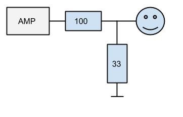

To make sure I'm less likely to mess this up, is this what each channel would look like? (Please see attached.)
Should the resistors be 1W rated or can they be less?
Boulos
    • Posts: 5892
Reply #7 on: December 11, 2014, 07:43:56 PM
Your connections look good. Use 2-watt resistors (minimum) to be sure it is still safe if you wire for 32 ohms.

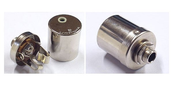

Thanks Paul!  I'm going to go with the Vishay CPF3 (3 Watt) resistors. For the resistor housing, I found a neat Switchcraft jack (see picture).  I hope it will fit all 4 resistors :)  I will update the thread once I make this.

I completed this. The improvement to the sound of my headphones is very noticeable (they're AudioTechnica Air ATH-AD700 open headphones). It's finally enjoyable to listen to them.  I will post the procedure in a new thread soon.  I made a mistake initially in the build where I connected the 33ohm resistors to ground at the point between the amp and the 100ohm resistors (as opposed to the point between the headphones and the 100ohm resistors). I discovered the error while doing final resistance checks and I was able to easily correct it, but unfortunately it rendered many of the photos I took during the build useless. So.. less photos in the new thread, but hopefully the instructions will still be clear.
