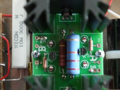

The jumpers and R1 resistors are in the correct positions. I verified the values with my DMM and visually verified that the board matches the pictures in the assembly directions. I am attaching a picture if that helps, but it is slightly blurry.

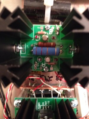

Are you certain those are PN2907a transistors on the board? They look more like the 2N2222a transistors on the SR boards.
Of course they could look different but maybe the same part. Here's a picture of mine for comparison.

The transistors that came with the kit looked like yours (black plastic with one flat side). The replacements they sent from Bottlehead are shiny metal and are marked 2N2907A - they look just like the 2N2222a. Since Bottlehead provided them to me, I figured they were interchangeable. When one of them shorted out during testing I borrowed one from my unassembled Eros kit that is marked 2N2907 (no "A" as a suffix). It is slightly larger than the part with the "A" suffix. Could this be my problem?
I also borrowed one LED from the Eros kit to replace an LED that got mangled during construction. This looks exactly the same to me as the originals. Can it not be interchangeable?

Ok, that's fine then, just thought to check. Transistors probably just vary a little as BH gets new stock.
As far as I'm aware all the kit LED's are the same.

PN2907s and 2N2907s are interchangable, as long as mounted correctly. You should have gotten PN2907s, however. The board shows the part outline, so is the tab on the transistor where the tab on the outline is?

Yes the transistors are mounted so that the tabs line up with the outline printed on the board. Are the 2N2907s interchangeable with the 2N2907As?
