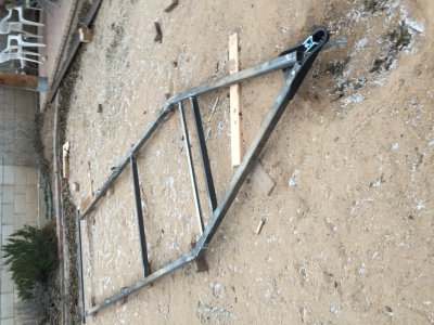

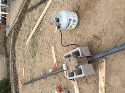

Alright construction has begun! In the Bottlehead spirit of DIY, we built a brick oven to get the steel tubing red hot. Then, we used a jig to bend it to 25 degrees. I'm actually a little surprised it all worked. We'll put the axle and wheels on soon and get it registered.
Also, the Quickie and Quicksand kits arrived, so I'll be designing the panel soon. More to come...
