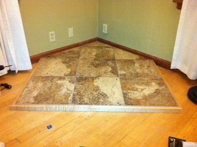

After 27 years without a fireplace or woodstove we have decided to gift one to each other this Xmas. Just got the hearthpad finished after work and the stove gets put in Friday. Yipee, no more freezing when the power goes out!

Are the 2 back walls going to be lined with some type of heat resistant material ?

Looks like a pad for a Klipschorn.  :^)

Nope, not needed with the stove we are installing. They line them with refractory ceramic fiber that insulates and reflects the heat. The stuff is awesome, I modified the combustion chamber in our old oil furnace with it last year. There used to be a youtube of a guy draping some over his bare arm and blasting it with a propane torch, but I think maybe it was removed.

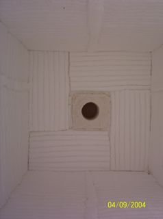

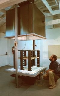

That's the same stuff the Shuttles used as a re-entry shield. My kilns use it as a lining; and 6" of it reduces the 2400F inside temp to 225F on the outside___ pics attached.  Cheers, Hank

Amazing stuff..

That's some nice looking maple around the edges!
