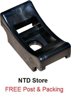

I just got some Russian K75-10 capacitors in for the Quickie today, and man, they have some weight to them!  Does anyone have ideas how they can be mounted into the Quickie 1.1?  A lot of people seem to use zip ties, so I got the kind that have the loop on them so you can put a screw thru it, but that won't fit.  Is there something else secure I could zip tie to?  Thanks in advance,

What about something like this
(https://forum.bottlehead.com/proxy.php?request=http%3A%2F%2Fi.ebayimg.com%2F00%2Fs%2FNTA5WDM4Ng%3D%3D%2Fz%2FLg8AAOxyyF5RMg5h%2F%24T2eC16FHJGkE9no8fzejBRMg5hLP%29w%7E%7E60_1.JPG&hash=230c8ea9936d974703eea610feeec1a339967966)
http://www.ebay.co.uk/itm/10-X-13MM-CABLE-TIE-TIES-MOUNTS-SADDLES-BASES-WRAPS-CA5-/171002682531?pt=UK_BOI_Electrical_Components_Supplies_ET&hash=item27d08ddca3
Reply #2 on: December 23, 2014, 11:40:43 AM
That looks a lot more sturdy than 3M "Sticky backs."  The stick is only temporary.

Looks interesting, though i'm hoping for something that could be bought at a home depot or lowes, so I can fire up these caps tonight :)  How about those metal eyelets with screw threads on one end, maybe screw it into the wood case, then zip tie to that?  Seems like it would be strong, but might move side to side?
