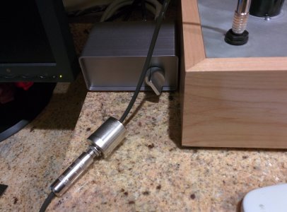

Attached is the completed device I built.
The improvement to the sound of my headphones was very noticeable. Now I could the volume pot up to ~10 o'clock (depending on the recording). The hum is almost entirely gone, and the headphones finally sound good!

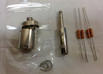

Attached are the spec sheets for CPF resistors, the headphone plug and the jack (this is for the CN12A--2 conductor version, not CN12B but the sizes should be the same), and a picture I took of the parts.

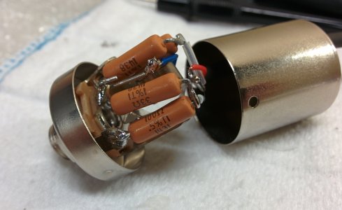

Prepare the resistors: This step is needed so that the resistors sit low in the jack and prevents them from touching the metal enclosure. If you're going for 2W resistors, this step is not needed. Do this for each of the four resistors only on one of the leads:
- Bend the lead close to resistor body (call this the y-direction).
- Bend the lead again at 2mm away in the z-direction.
- Trim this lead slightly.
The resistors should look like Picture 1.

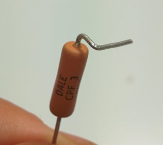

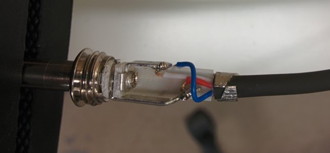

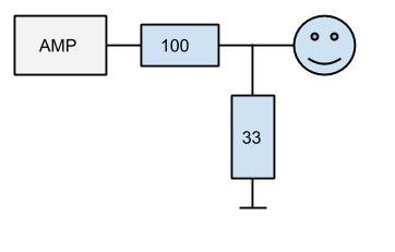

Unfortunately I don't have pictures at the various stages below since I made a mistake initially and it shows in the pictures I had taken.  Hopefully Pictures 2 and 3 of the final correct build are sufficiently illustrative. Please refer to these pictures when reading the instructions below. The schematic for each channel is also attached.
Tip resistors:
- Attach and solder the prepared lead of a 100Ohm resistor to the eyelet of the tip terminal.
- Attach the prepared lead of a 33Ohm resistor to the sleeve terminal (ground). Do not solder.
- Bend the free lead of the 33Ohm resistor close to its body toward the 100Ohm resistor, and wrap it around the 100Ohm resistor's free lead close to the 100Ohm resistor's body.  Solder this connection taking care not to damage the 100Ohm resistor.
- Bend the free lead of the 100Ohm resistor toward the ring terminal making sure not to touch it.  Use a 1cm wire insulation to cover the part of the lead that passes above the terminal. Then make a small hook at the end of it and trim the lead.
Ring resistors:
Repeat the above steps for the ring resistors making sure the 100Ohm resistor lead is bent toward the tip terminal in the last step.
Sleeve terminal:
Make two hooks at the ends of a 1.5cm bare wire. Attach one hook to the sleeve terminal where the two 33Ohm resistors attach and solder this joint. This wire allows all the headphone wires to be the same length when trimming them.
This completes the jack setup.

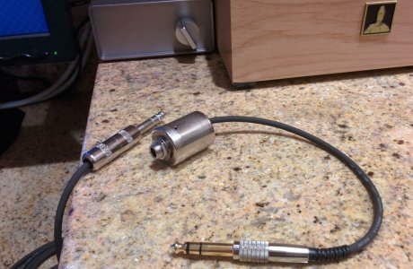

Plug and wire installation:

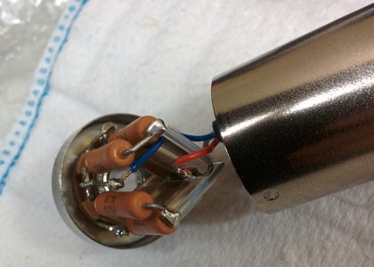

- Prepare the wire as shown in Picture 4.
- Insert the metal enclosure into the wire.
- Connect (a) one wire to the 100Ohm tip resistor's free lead. It should go in the hook you created at the end of the lead. I connected the white.
- Connect (b) another wire to the 100Ohm ring resistor's free lead. It should go in the hook you created at the end of the lead. I connected the red.
- Connect (c) the last wire to the extension connected to the sleeve terminal (ground). I connected the blue.
- Do not close the case yet to allow for the resistance check.
Plug:
- Insert the plug casing in the wire.

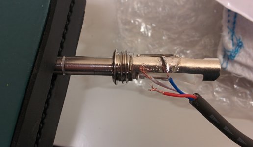

- Make the three wires the following lengths: Sleeve (c) 1", Tip (a) 3/4", Ring (b) 1/2" and trim each 1/4".
- Lift the insulating plastic attached to the sleeve terminal. Connect wire (c) to it from the back. See Picture 5.
- Return the insulating plastic to its original position. Connect wire (a) to the tip terminal (the shorter one), and connect wire (b) to the ring terminal (the longer one).

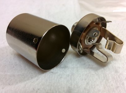

- Bend the ends of the sleeve terminal around the wire. See Picture 6.

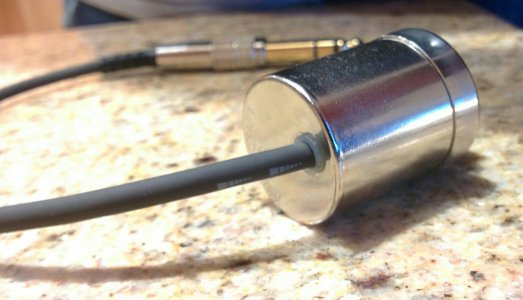

Finally, gently close the jack case.  I didn't close it all the way (there are holes that fit into indentations). It will be very difficult to open it later if you close it tightly. Also, I was worried the resistors would hit the back of the case.  After closing the case, repeat the plug resistance checks.  Pictures 7 and 8 show the final assembly from the back, and shows it attached to the amp.
