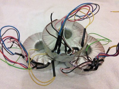

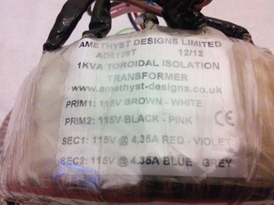

They are currently listed on eBay for £35 each so i couldn't pass it up at that price.  I got it with the thought of making an isolation transformer for tinkering with amp circuits from a safety point of view.  Already have a variac and a light bulb limiter, this completes the set if you like.  While researching that i found a lot of discussions on audio forums singing their praises, hence i thought i would ask the opinions from people i trust.
The transformer itself has two 115v primarys, and two 115v secondarys so i am going to wire both primarys in series (240v mains), and wire the two secondary windings in series with the center point connected to mains earth. Hence creating a 120v-0-120v balanced winding.  If anything it will be another fun project..
P.S. Bonus points if anybody can tell me what the two yellow wires are for?
Reply #5 on: December 31, 2014, 12:22:33 AM
Grab your meter and see if the yellow wires are connected to the windings.  If not they might be internal shields.  Ground them.

Reply #7 on: January 03, 2015, 02:02:37 PM
