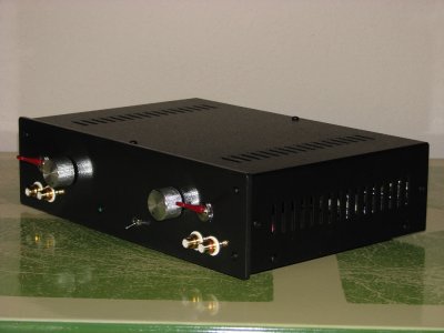

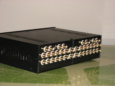

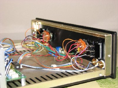

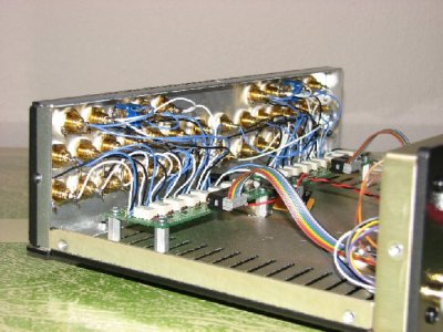

8 years ago, I wanted a multisource input/output selector box, capable of many in to many out, and didn't want to use mechanical switches. All my electronics except DAC's are tube DIY, including Bottlehead, and many own design. I focus on Analog and Tape (3 RTR, 1 cassette, 2 TT's, 1 Tuner, 1 CD deck, 1 ADC). Although not a 'purist' approach, having an interface selector box for multiple sources is at time convenient, and cuts down on the cable swapping, etc. Also for DIY, future projects can have only a single input, saving cost and complexity.
Inspiration was the Manley Labs SKIPJACK http://www.manley.com/msj.php, but it was limited to a bidirectional 2IN/3OUT, and cost $900. My unit uses relay boards, completely separate, essentially 2 x 2IN/6OUT or 6IN/2Out .... you get the idea. I can even use the 2 sections together, by "patching" them together.  Each section also has a switchable processor loop if needed.
I used a Par Metal case, and a clean 5V wallwart for power. Direct connection to all I/O RCA's with silver Teflon wire. All RCA's chassis isolated, and each pair has it's own separate ground connection to the I/O board. There is no signal ground to the chassis, the 5V is grounded to chassis, and a hardwire chassis ground to the total system ground.  (I do use a power conditioner that all equipment is behind.) Use of this device has not induced and hum or signal degradation into my system that I can hear or measure, using good quality interconnects.

This is incredible.  Skipjack was originally my inspiration as well, but at $900, it was just too spendy.  I love your silicon based approach.  I was actually considering rigging something up using a Raspberry Pi attached to a a touch screen.  Either super lo-fi or super hi-fi.  Decided with the former, but may eventually move to the latter.
Regardless, I love your approach.

Reply #14 on: January 07, 2015, 08:37:57 AM
That really is a nice looking switch box. I've been contemplating building something almost identical for a while as a passive source selector using relay switching. The only additional thing I would add for my build would be a Penny +Giles RF-15 10K log Rotary Fader. Not cheap ( around $400 for a stereo pot) but accurate and a really beautiful feel to them because of the type of bearings used.
