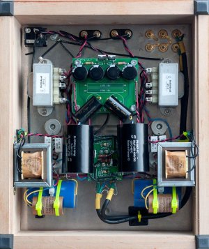

I think I need to stop messing with my Stereomour now..  :P
Since I built it about a year ago, I have been constantly changing things.. Here is a list what I have done:
1. Rectifier diode changed to Cree 5A/1200V schottky
2. 3.3uf parafeed cap changed to ClarityCAP MR
3. 0.1uf interstage cap changed to Duelund CAST-PIO-Cu
4. Cathode bypass cap removed and replaced with 56uf Solen metallized polypropylene
5. The last PS cap was bypassed with 1uf Mundorf Superme
6. Input selector switch and volume pot were removed
7. 1200ohm and 360ohm PS resistors were removed and replaced with Triad C-7x chokes
8. Input wire was changed to some type of Mogami wire
I have heard a lot amps but I have to admit this is the best amp I ever have, it is time to let it be and just enjoy the  music! or... maybe I should replace that 100uf PS cap with something like ClarityCAP TC series metalized film PS caps?? LOL!
Thanks for the Bottlehead team to bring this wonderful product to me!
« Last Edit: January 06, 2015, 11:01:08 AM by jerryZ »

Super nice build Jerry!   Nice and clean.
Looks like a million bucks and sounds good to boot.
Enjoy the sweet tunes.....take care...Dave

Very sweet! How are those big Solens managing to stay there?
Offline jerryZ
    • Posts: 8
Reply #4 on: January 07, 2015, 02:34:04 AM
They were soldered directly to terminal strips under the C4S board, space is very tight there and there are some other wires going to the same terminals, so it did take some efforts for me to get it done properly.. it would be better if I can somehow secure the Solen in order to reduce vibration,  but I can't figure out a way..

Looks great.  Do you know which mods gave you the most improved sound?
I have upgraded to Sophia 300b and a NOS Telefunken 12at7.  I have also replaced parafeed caps with Auricaps and the Interstage caps with Rikes caps.
Can you suggest another mod that would improve my sound the most out of the additional mods that you have done?
Wayne
Offline jerryZ
    • Posts: 8
Reply #8 on: February 03, 2015, 06:05:16 AM
Wayne
IMHO, The mode that brings most improvement is replacing parafeed and interstage caps, which you already did.
The next big improvement for me is removing the volume pot and use a passive TVC pre-amp to control volume.
Use choke in the PS and replace cathode bypass cap with Solen do improve things but in a more subtle way..
Cheers
Jerry
