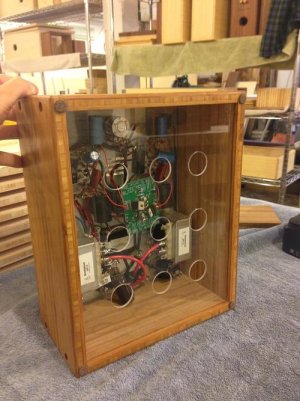

Reply #9 on: January 13, 2015, 03:09:25 PM
Another option would be an acrylic/perspex base, like Blumentstein bases:

Reply #10 on: January 13, 2015, 08:40:25 PM
Oh man, so many choices:)
