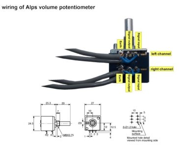

I heard back on this from the vendor I purchased the pot from and was told that the wiring for AN is the same as Alps. I've attached what he sent me. Isn't this the same as the stock pot (just to be sure)? Thanks!
John
Crack
Offline Big Al 954
    • Posts: 31
  • Master of the Dark Arts (Broadcast)
Reply #6 on: January 22, 2015, 01:39:09 PM
Yep, spot on.
Build with confidence  :)
