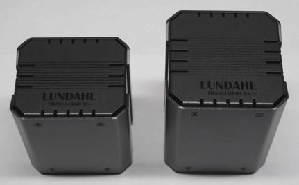

I've seen several builds that use transformer covers, and I like the look of that. I have searched on information about potential downsides (higher transformer temperature), but I haven't found much, a couple of threads on old Bottlehead forum.
As I understand transformer on Crack gets pretty hot. Would perforated or vented cover help? I've seen such feature on several commercial tube amps, and Lundahl transformer covers also have this feature.
(https://forum.bottlehead.com/proxy.php?request=http%3A%2F%2Fwww.kandkaudio.com%2Fwp-content%2Fuploads%2Flundahl_covers.png&hash=4e5b0b687c7c83452d18b00fe03c8cb8d8bddf18)
So, would an oversized stainless steel cover, vented on the back be OK? I'd also add holes around transformer on the amplifier case, and the bottom plate will also be perforated.
Reason for transformer cover is mostly visual. I doubt electrostatic or magnetic shielding is needed.
"Pezze Ritter Wenne Knecht!"
Reply #1 on: January 28, 2015, 09:12:58 AM
Temperature rise is the potential issue. Since we have not experimented with covers, we have no data to share. You will just have to try a design and see what happens. I would suggest designing a new bell end rather than a cover for the entire lam stack. That will remove the potential of the transformer overheating from lack of airflow. Years ago we kicked around the idea of a bell end that had cooling fins.
