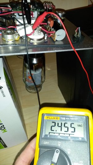

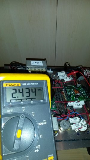

Reply #11 on: February 09, 2015, 09:17:28 AM
So I borrowed a Fluke multimeter and the results are good  :) .
So my own multimeter has problems with measurements of low AC volts.
Paul you were right!
Thank you.
