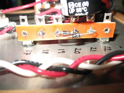

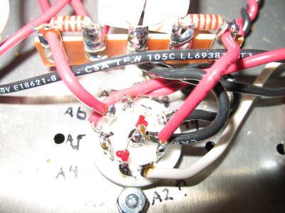

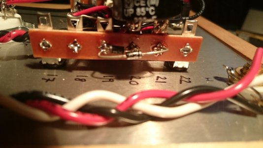

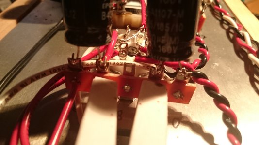

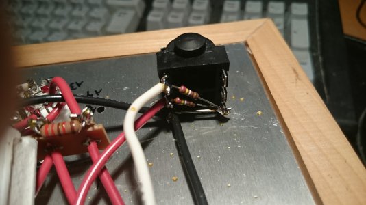

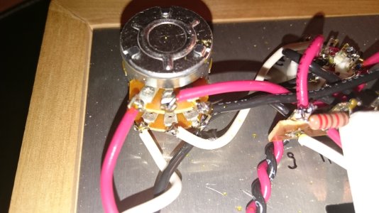

Here are some pics that I took:
https://imgur.com/a/XkniP/
Some of them are not great, so please tell me if I should take some more.
Edit: Attachments is in my next post.

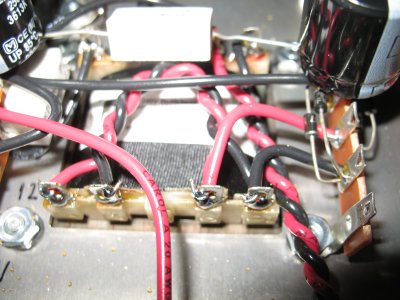

Some of the wires on the transformer look badly soldered, but I have pulled on them and they are not coming loose.

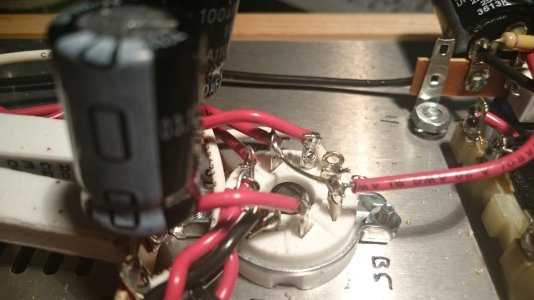

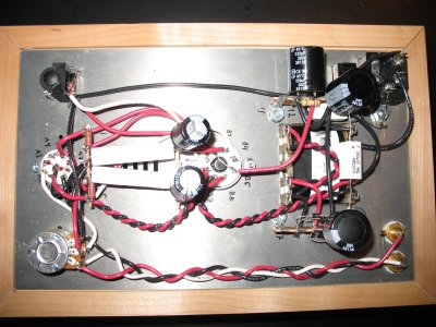

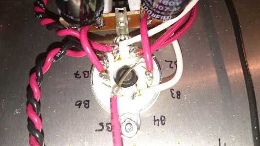

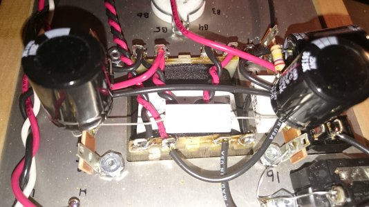

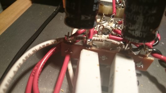

    • Posts: 20297
Reply #14 on: February 05, 2015, 06:32:52 PM

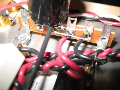

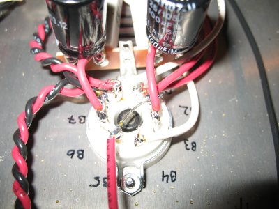

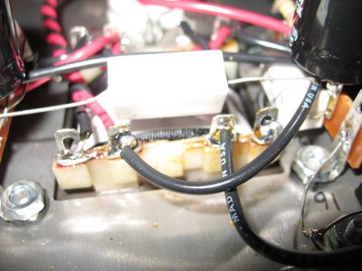

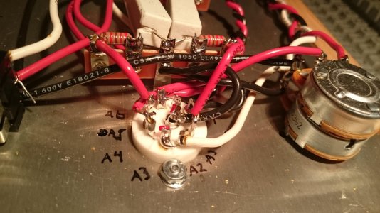

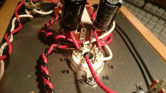

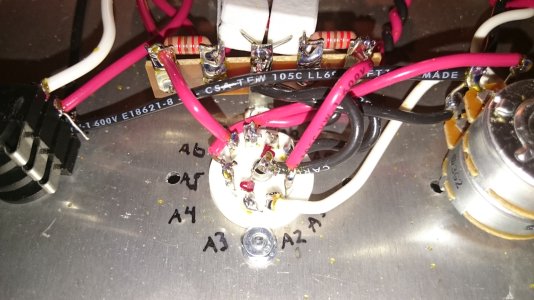

Thanks for posting up all the pics.  Here's what I would do if I had the amp on our repair bench:
1.  There's some bit of bare lead poking out around the headphone jack, I would look to make sure that wasn't loose, clip it off, and reflow that solder joint if necessary.
2.  The wire from B3 to 7 looks suspicious.  It looks like on the tube socket end, the bare wire just barely pokes through the tube socket terminal, and on terminal 7, it looks like the insulation may be in the terminal strip hole a little bit.  If you wiggle that wire, does it move on either end of its connection?  I would probably just remove that piece of wire and replace it with one slightly longer, then take half a wrap on each end to secure it.  The B3 end may OK, it's just tough to tell if the bare wire is bent up against the socket terminal (which is a good thing if it is)
I'd start with those two and see if things change.  By the way, you have some of the nicest looking twisted wire that I have seen in a long time!
