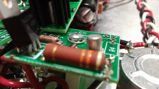

Just bought a used crack and once of the MJE leads broke during shipping.  Is there a way to resolder it or do I need a new one.  The lead broke where it meets the board.  The remaining lead is after the taper and too thick to insert in the hole.  Any help is greatly appreciated.

Is this on the MJE350 or TIP50?  If it broke at the board, just apply a tiny bit more solder.

I believe it's the MJE350.  Worried the lead pieace in the board would fall out or the connection won't be strong enough.   So just add a bit of solder from the top side and leave the broken piece in place?

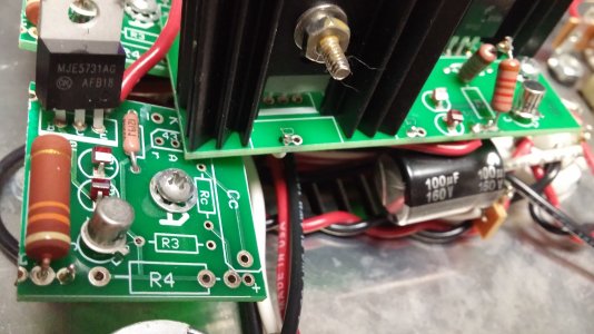

Reply #3 on: February 05, 2015, 11:28:08 AM
Here's a better image.  Yellow line is where it snapped.

Mouser has this part for under a dollar. I would look to replace the part.

That looks solderable, but you'd have to try it to find out.
It is worth noting that it's not the stock part, and neither are the visible resistors. The larger resistor on the small board is quite clearly the wrong value, the small one isn't legible, so I can't know. Did your seller disclose the nature of the modifications he did?

This was apparently one of the first speedballs, built in house by BH.  Here's the link to the original listing.  https://www.head-fi.org/t/670457/sold-limited-edition-bottlehead-crack-speedball-mint-condition-price-drop  Changed hands a couple times before I got it.  Everything looks the same as the OG picture though.  I'm assuming the guys at BH changed some parts when they decided make this a regular production part.  I could be wrong though.  Any issues you see with the parts in the listing pic?  Many thanks!

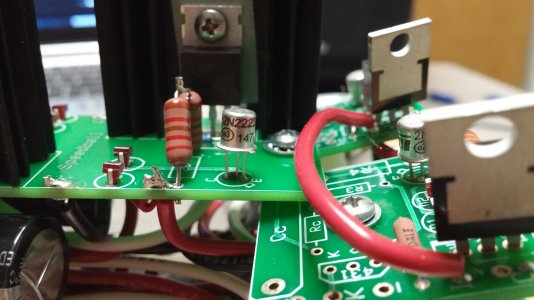

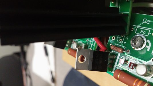

More pics

That looks like a very simple fix to me. Just straighten the transistor and put the tip of the iron right in the corner made by the busted lead and the solder pad and flow some solder to make a good fillet. No problema.

Yes, I built this amplifier.  These are incredibly rare and certainly something to hang onto!
If you have any issues getting it working, this does fall under our flat rate repair service, and we'd be happy to take care of it for you.
As Doc B. said, just hit that leg with your soldering iron and you should be OK.
