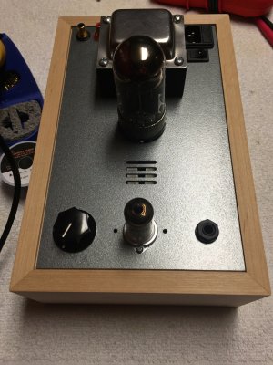

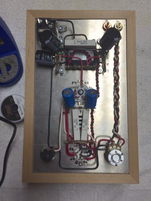

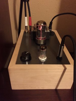

I just finished up my Crack, everything measured right first time around, no problems. Listening to it now and it's awesome. I'm using it with the preamp now, sounds great, but I'm about to switch it over to the tape out to bypass the Mcintosh. I don't believe I'll be needing any eq.

Reply #8 on: February 15, 2015, 08:59:16 AM
Congratulations! ! !
That's nice neat work.  That would make troubleshooting easier.  And it will make modifications so much easier.
    • Posts: 20299
Reply #9 on: February 16, 2015, 06:57:58 AM
Squeaky clean! That's how you twist and braid, well done!

Thanks guys, I hadn't soldered anything since I was a kid. I took my sweet time. I was originally going to get it with the speedball, but I read multiple times to build it stock first. I really do like how it sounds stock and I'm even debating if I should build the speedball. I figure I'll run the Crack stock a while and get a good feel for it before I decide what I need to upgrade, if anything. I should note that I'm using it with the 150ohm HD700, not one of the 300ohm Senns. I know they're not the most loved cans, but I really do like its sound. I was concerned about the lower impedance with the Crack and almost got the Sex, but I read that a few people really liked the Crack with the HD700 so I gave it a shot. And I'm glad I did. I am thinking of giving the HD650s another go, I didn't care for them when I first auditioned them, but everyone goes on and on about the pairing.
