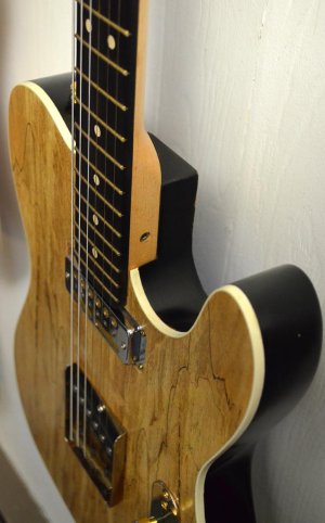

Somewhere I have pics of a spalted maple guitar I finished with French polish. French polish is beautiful. It will take days to do, maybe weeks. Your wrists will ache and you will get sick of the smell of shellac. But the particular tone and sheen it has is beautiful. It's not necessarily as deep and glass-like as a flood coated, scraped and hand rubbed nitrocellulose lacquer over a shellac filler finish - which also takes many hours of rubbing. French polish is more easily repaired - though that is more of a plus on something like a guitar that is handled constantly. It is not very water resistant, though that shouldn't matter on an amp base!
If you are a seasoned DIY adventurer go for. If you would rather start at the shallow end and work your way into deeper water I'd suggest spraying carefully sanded layers of water base satin finish clear as the most fool proof method. Looks very nice too, that's how we have done many bases here at BHQ. Another alternative is gunstock finish - nowadays we use a lot of Tru Oil for its speed of application and simplicity.

Lots of ways to do it. You can put aniline dye powder intended for use with alcohol right into the shellac.  The back of this guitar was french polished with the shellac heavily tinted that way with a dark walnut powder, and the front polished with un-tinted shellac. I used pieces of an old 100% cotton t-shirt wrapped around a small block of wool felt for the ponce. I also used Bull's Eye shellac primer, which is essentially a thin cut of shellac just about right for polishing. Look up french polishing guitars - lots of great info on the web.
