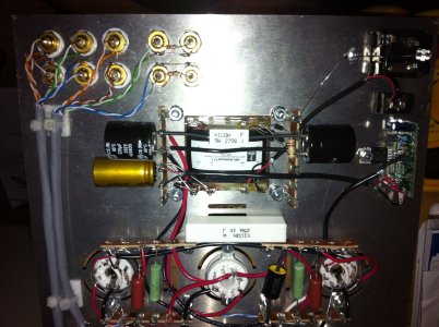

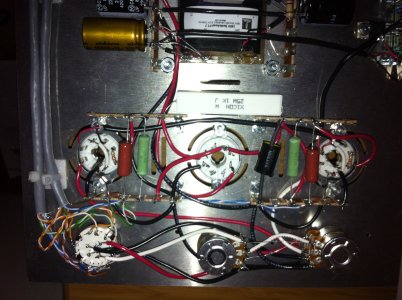

I can't answer your question about resistance tests, but I noticed something in your pictures you should fix before doing the voltage tests.  The drain wire of the STP cable going from the power switch to the power supply does not appear to be connected.  You should either connect it wherever it goes or trim it.
By the way, from what I can see in the pictures you have done a great job on the solder connections!  Very neat.
Ken Goss
