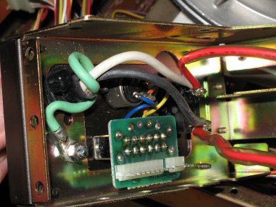

So I am starting the up grade process for my RS 1500 tape deck and one of the things I want to do before I start on the BH tape path mods is install a better power. I am going to use 14 gage three conductor wire. Will it be OK to connect the green ground leg to the chassis?

Yes, the metal chassis is the appropriate place for the safety ground.

Actually, adding the chassis ground to my RS1500 created hum so I disconnected it.
Of course, this could have something to do with the downstream gear but I exhausted all the usual suspects and didn't think it was worth any more time and effort.
What I would advise is to do all your other upgrades (external repro amp and wiring, Doc's excellent tape path upgrade, upgrade heads) before you worry about the power cord.

That's weird, as I was putting in custom panels cut for an IEC to replace the stock power inlet and I don't recall a problem. But there were also a few different power inlet wiring schemes used. on those decks.

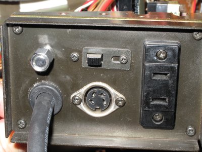

Reply #4 on: February 23, 2015, 05:15:44 AM
All,
Thanks for the responses. I went ahead and replaced the cord as shown in the photos. I thought about modifying the back plate to fit an IEC socket but felt the metal work involved was not worth the effort. Perhaps in the future I'll consider doing it. At this point I am into replacing the break pads. I'll post images of the project as I go through it.
If  Technics chassis is grounded via power cord, outbord repro is grounded via power cord and  Technics chassis is  connected via ground wire to a ground post on the  repro , that creates ground loop and a lot of hum.  Don't ask how i know...
