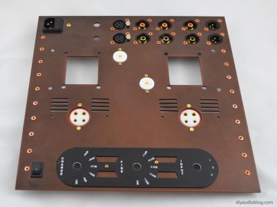

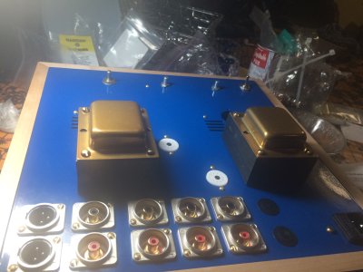

My BeePre is coming along pretty well so far. Those transformers were a little tricky to mount, I have to say :o
I have some sweet Jupiter caps in store. Stay tuned :D

That's a cool color scheme.

Wow.  Makes mine look like a hack job.   :o

I'm with PB, the color scheme is very nice.  Interestingly restful.
Nice work!  I look forward to more pictures.

As always, a very luxurious look...

Great look - Awesome rivets! I am building mine now too. I noticed the rubber ring under the tube socket - good time to put that in!
What is the extra terminal strip in the inputs for?

Thanks for your great comments guys (my fellow Bottlehead enthusiasts ;D). I'm a sucker for browns, tans and copper colors, anything on the warmish side.

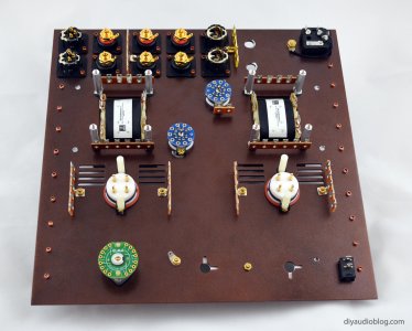

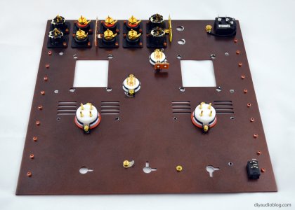

I decided to use Teflon sockets for this build as they dampen to some degree (for the big 300Bs). The teflon sockets are notably smaller than the stock sockets, so in order to get them installed and not to fall through the other side, I had to use the o-rings, which is serendipitous anyway as they decouple the sockets from the chassis. After installing, I noted that the round headed screws interacted with the 300B base, so I swapped them out for flush mounted screws. While not as pretty, they offer the necessary clearance.
The additional terminal strip is actually for the input transformer, so I can have a balanced input.

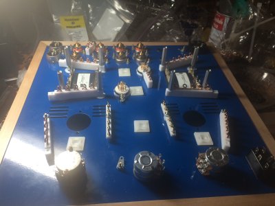

Reply #12 on: February 26, 2015, 01:43:22 PM
Never thought of rivets as decoration. Great idea. I even have access to one at work.
Just finished mounting my hardware except for the large tube sockets.lots of teflon.

Reply #14 on: February 27, 2015, 07:28:02 PM
Look at all that gold and teflon! :D
