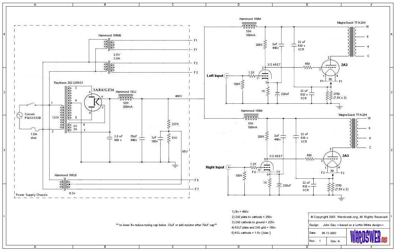

Let me know your thoughts on this design I originally built back in 2003. What would you change, if anything and why? I have always liked the sound but not happy with the heat from the dual 7.5K resistors to ground.
It was built using a two chassis layout (power supply and output). The dotted line denotes the power supply chassis.
http://wardsweb.org/audio/2A3/DC2A3%20Full%20Schematic.jpg
(https://forum.bottlehead.com/proxy.php?request=http%3A%2F%2Fwardsweb.org%2Faudio%2F2A3%2FDC2A3%2520Full%2520Schematic.jpg&hash=9680d70fe8881dd4c5d3bf078ae17c7ede231d8b)

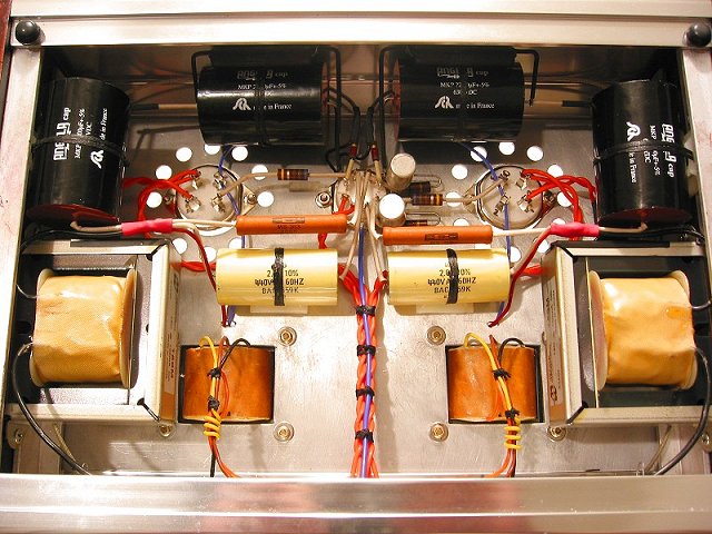

Here is what the output chassis looks like.
(https://forum.bottlehead.com/proxy.php?request=http%3A%2F%2Fwardsweb.org%2Faudio%2F2A3%2Fcomplete640.jpg&hash=01f21d82f3e4449e4a7c9bfe7e66037dd6a549a1)

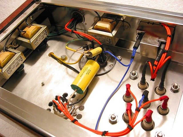

Here is the power supply built.
(https://forum.bottlehead.com/proxy.php?request=http%3A%2F%2Fwardsweb.org%2Faudio%2F2A3%2Fpowerwired640a.jpg&hash=14baf8e04bf0c47b6a3dd407b5cc6d50c86cdbab)

Have you ever measured the frequency response? We did a direct coupled 6SN7/2A3 many years ago, that rolled off above 7kHz. We figured it was probably the Miller C of the 2A3 that was causing the problem. When we changed to a driver tube with a lower output impedance the response came up where it should have been. This was maybe 12 years ago and memory is a little foggy, but I think we must have changed to a 6SN7.

I like the power supply concept.  I'd agree with Doc on the driver.  If it were me, I'd loose the SL7 and also the direct coupling.  I'm not a fan of that topology anymore because the bias voltage of the 2A3 is at the mercy of where the driver is operating.  It's great for a tweaker that is always monitoring the operating points but as soon as that driver tube ages, all bets are off.  Since you are already octal, a 6SN7 would be a natural choice and CCS loading would be nice too.  If you went cap coupled, you could also switch to 300B if you have a little extra current capacity in the power supply and get rid of the big power drop across the cathode resistor.

I had an amp once with a SRPP front end. It was convenient because the same cathode resistor worked well for both 6SL7 and 6SN7. They could be swapped with just a gain change (10dB of gain change!). Hands down, the SN7 sounded better.
Of course, since then I've abandoned the SRPP in favor of C4S loads, and that amp was converted to a 6J5. Then I got into parafeed so it just sits on the shelf these days....

Your build skills are quite magnificent!  If you can knock the B+ down a little, go with a cap coupled driver.  Try a 6SN7 at about 3ma with an 2.6k resistor under the cathode and a C4S plate load.  This will give you an amp with low input sensitivity, and allow you to really drive the 6SN7 with your preamp, getting adequate drive voltage for the 2A3.
Also, the high frequency response should be much more even with the low Rp 6SN7.
