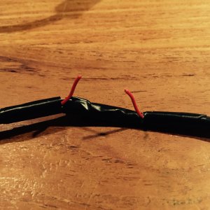

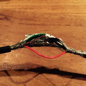

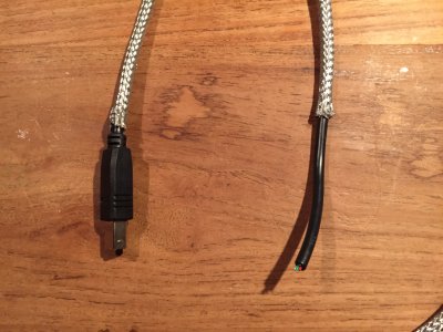

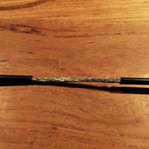

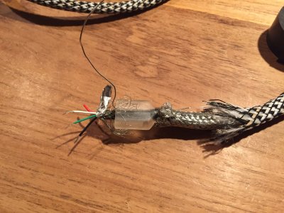

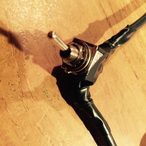

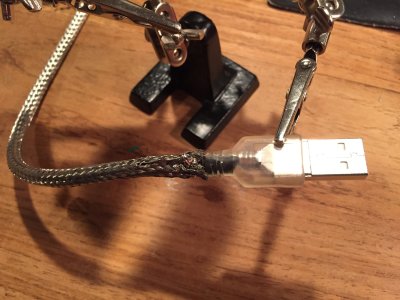

So grab yourself an USB cable (should be 2.0 certified) that you don´t need anymore. Remove the insulation near the source plug. Carefully loose the braided shielding and separate the red wire that carries the +5 Volts. Cut it and put a switch in.
That´s it!
Now you are in the comfortable situation to make a real A/ B comparison by listening and switching back and forth.
The result is not predictable as it depends mainly on your source computer and how much dirt it infuses into the power wire.
In my case I noticed a wider soundstage without the power wire. I did concentrate on a trumpet of a big band that was placed on the left side. Without the power wire it´s place was about 2m further away and a bit more reflections of the surrounding room were audible. Note: the effect took about 1-2 seconds to show up when switching off but nearly instant when switching on again.
It´s an easy project that costs nearly nothing and could give you a slight improvement or the certainty that there is no effect.

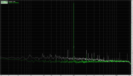

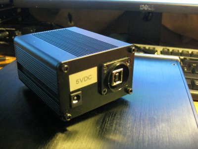

I found the 5v rail on my computers USB bus to be incredibly noisy so i built a small box with an ADUM4160 isolator powered by a low noise TI TPS7A4700 regulator for my USB powered DACs.   The difference it makes varies from one DAC to another but there is a small audible and measurable difference in my opinion.
The RMAA trace below shows a PupDAC (USB Powered) being fed direct from the PC, vs an isolator with a LM317 power supply (Beezar Doodlebug).
For the BH DAC the isolator has to go as its only USB 1.1, but i am going to measure it with the direct USB supply, vs my own USB power supply and see if it makes any difference at all.  I suspect it wont from what John has said so far, he seems to have gone to great lengths to isolate the input side of things.
