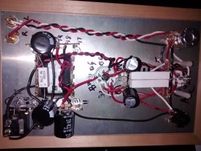

Reply #7 on: March 09, 2015, 09:17:03 AM
Here's a quick picture, thanks for the any help.
    • Posts: 20295
Reply #8 on: March 09, 2015, 11:30:46 AM
Check your UF-4007 diode orientation, as well as the trail of black wires back between the two terminal strips.
You should get significant DC voltage between 20 and 21.  If you get close to 0 Ohm resistance between terminal 20 and the chassis plate, and no voltage at 21, you either have a nasty short in the power supply (the 270 Ohm resistors would fail immediately based on how low your voltages are, and the power transformer would be buzzing).  Since these conditions aren't happening, then it is most likely that the diode bridge is improperly wired.
There is also a suspicious looking connection at terminal 19. If the red wire is making contact with the two diodes that come from terminal 18, then you have shorted out the high voltage windings on the power transformer, which will leave you with low power supply voltages.
Offline tonyalves88
    • Posts: 14
Reply #9 on: March 09, 2015, 03:36:25 PM
Hey Paul thanks for all the help, your the best! So diode orientation seems to be right, I'm sorry I don't follow when you say the trail of black wires back between the two terminal strips. The connection at 19 was suspicious, it turns out the red wire was making contact with the diodes from terminal 18 as you suggested. I moved it all around to insure none of them touch anymore, I also found an extra lead there I had not seen before, so I removed that. I plugged the amp back in and I noticed when putting my ear to the transformer I can get a slight buzz noise as well as occasionally what sounds like a clock's tick. They did glow again and fuse is ok. Voltages were still way off so I re-soldered just about every joint I could. I powered it back on and the buzzing noise is gone. My voltages are still off but getting closer I guess hah... Let me know where to go from here, can't thank you enough for your help I'm itching to hear this baby in action!

    • Posts: 20295
Reply #10 on: March 10, 2015, 05:41:16 AM
I would suggest remeasuring.  Having 75V at T1 and 24V at T2 is really quite impossible in this circuit, you may need to adjust the range on your meter. (Be sure you're on DC volts, etc)
Generally, terminals 1, 5, 7, and 9 tell the story of how the tubes are operating in the circuit, and these voltages look good.  Still, I'd take the time to get the measurements better sorted.
Additionally, I would reduce the amount of exposed bare red wire that you have at A4/A5.  If that wire bends down and touches the plate, more anomalous issues will occur.
