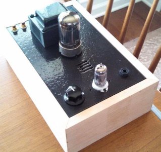

So ... I finished building the Crack I started in July 2011 yesterday. I was living in another state when I started it.
Two things are amazing, I didn't lose any parts and the Crack does sound great.

Reply #3 on: March 07, 2015, 10:28:33 AM
Hey Paul,
Yep -- she's a running. You did a great job!
I had a resistance measurement fail at terminal #22. It was open (not connected to ground)
I put fiber washers (as instructed) under the pwr transformer to the chassis.
After inspection, I noticed, I also put fiber washers between the pwr trans on the underside of the chassis and terminal strips, numbered 11, 16, 17, 22. This is a total of 8 washers.
I read the instructions again, I built this part up in 2011, and didn't see that step. But I do see the washers in the photos.
I tighten the pwr transformer screw that connects to terminal #22, and that corrected the bad ground connection for the heater supply return. I might have gotten paint under the transformer top bell. With the risk of creating a ground loop (it didn't in my case), I installed a short as possible piece of buss wire from the safety ground to terminal 22L. I doubt it was necessary.
