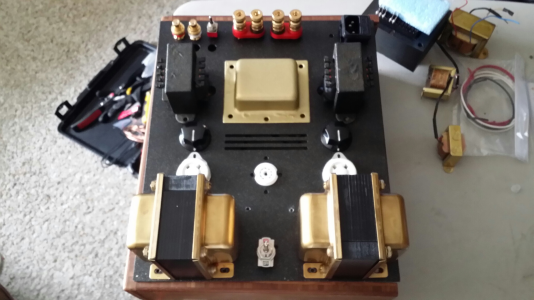

Reply #6 on: March 14, 2015, 05:14:59 PM
Got my Stereomour in yesterday and got her painted.  Rough layout pic attached, starting assembly tonight.

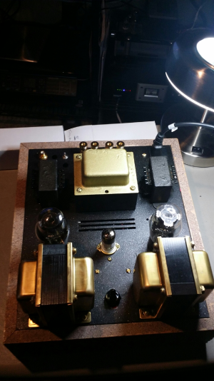

Assembly done, resistance checks were good.  Voltage checks were off at C1, C4, 11 and 20 (26, 25, 31, 20 VDC).  All about half there expected values.  I swapped 45's and the low values followed the tube.  Replaced and sound checked but no (very little) sound, I have to turn the Smash all the way up and I can here low music from both speakers from a couple of inches away.  I must have messed something up with either the input 100K resistors or with the output transformer hook up.
Gonna take a pie break and check it later.  Here's some pics of the build.

Reply #9 on: March 16, 2015, 08:29:18 PM
One step closer, remembered that I'm not using the OT-2 so I lifted the ground wire to the speaker black post and got good music from the right channel, not so much from the left.  The speaker terminals measure 6.8 ohms for the left and 0 for the right so I'm going to check all the connections back to the output transformer and see what's up.

    • Posts: 462
Reply #10 on: March 17, 2015, 08:46:42 PM
A new BH amp is alive and kicking.  Playing Gary Clark Jr. Blak an Blu as a debut album.  I had to go back to the OT-2's cause of some strange readings on the C side with the EXO145's.  Also had a problem with shorting B6,7,8.  But that's all fixed now and the magic is playing (softly cause its 1130 but wait till tomorrow :)).
Still to do;  3.3 Muldorf Supremes in place of the 4.7's.  Get the EXO-145's figured out and put back in.
