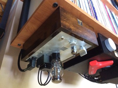

I painted the bell but not part of my original build. Simply masked off the entire crack with heavy craft paper and painters tape and left the bell exposed. One coat of primer and a couple of coats of paint, and we're done. Took more time to mask off the crack than it did to shoot some spray paint on the bell.
