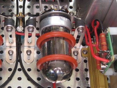

My understanding is that the 4P1Ls have an inherent micro phonic quality and there's nothing to remedy this entirely. What I have done is take two hydraulic system o-rings, that were slightly stretched, to fit over the glass envelope of the tube. While they don't entirely eliminate the ringing after adjusting volume or changing the input,  I find they settle down faster. That's my two pennies and I'm overly happy with the amp itself.

-Rubber damper rings on the tube itself which is cheap and effective.

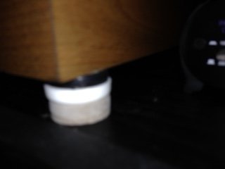

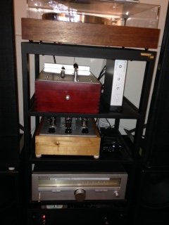

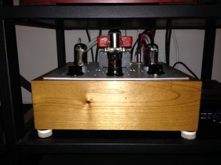

Not to be discouraged, I have now moved the smash to a new location, with auspicious results.  It is in a heavy target rack in a different room.  I added some feet with soft felt tips and mortite to where the top plate joins the wood frame (replaced the blu-tac).
Now in day 2 of listening and NO microphonics at all!
So maybe the other location (room, rack) was especially subject to vibrations?  New feet helped?
