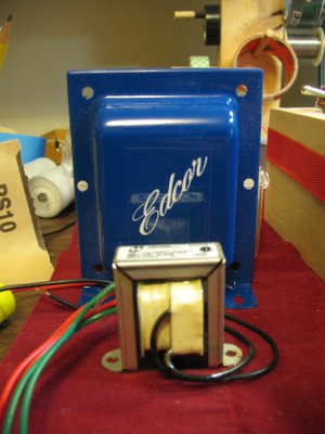

How about David and Goliath? Received the Allied transformer today and it's so cute next to 50 watt Push-Pull PT end bells.
