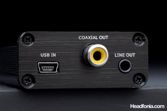

I noticed you mentioned the E10 has an optical in however if I'm correct its a digital out (Digital Coaxial RCA SPDIF).
According to the picture below:
(https://forum.bottlehead.com/proxy.php?request=http%3A%2F%2Fwww.headfonia.com%2Fwp-content%2Fuploads%2F2011%2F09%2Ffiio_e10_03.jpg&hash=8b181ef847d0df53d13f91a0541d9d6e005a7b4f)
If you use the coaxial out you can send the (digital) signal to another DAC ( it acts now as a USB-to-SPDIF converter) or amplifier with a coaxial input.
The Line out is to connect the E10 to an amplifier without internal DAC mainly.
You can only use the mini-USB to connect the E10 to a PC.
So if you want to upgrade on a DAC and want to play music thats on your PC/Laptop you can use the E10 as a USB to SPDIF converter.
You don't need another soundcard in that case.
There are many soundcards with a digital out (however you will not be able to connect it to the E10).
Sometimes making the right connections can be very confusing with all the possibilities these days :-)
