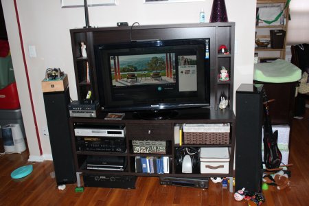

Here's a pic of the system:
The Quickie is on top of the left speaker, notice the light switch next to it.  It used to be on the other speaker, which also has a light switch next to it.  The amp is on the floor on the left (R500), and the box in the middle that says "the best is yet to come" has a wifi router in it.  Any ideas where to put the Quickie?

    • Posts: 20292
Reply #4 on: April 01, 2015, 05:01:11 PM
On top of the speaker is, without a doubt, the worst choice.
Go to your closest hardware store and pick up an inexpensive wall mounted shelf, then give that try.  (Or stick it on top of your TV as an experiment)

   Heck, for that matter none of your source components should be between your speakers.

I moved the Quickie to the spot where the tuner was (in the lower left by the tv) and hope to get a chance to listen to it tomorrow (the wife and son are asleep).  I'll probably try moving the cable modem and wifi to the opposite end of the room too and see what this does to the sound.  Hopefully it will be worth the effort of disconnecting and moving all this stuff!

Without knowledge of each of your components it is hard to give solid advice.  A wall shelf away from all the other components sounds good for not being there.
If you have a Radio Shack near I would suggest buying flexible 10' cables to and from the Quickie so you can move it around and see which components induce noise and which don't.  I would think a TV would be a noise inducer, but the pragmatic approach is conclusive.

I might have some cables like those around (think they are around 10 or 20 feet).  Interestingly enough, the Quickie picked up more noise next to the TV than on the speaker.  Might have to go with the shelf option, but i'm trying to find a way to try the Quickie behind the speaker where the shelf would go without installing a shelf at first to see how well it does.

I just moved the Quickie to the top of the entertainment center, and it is almost dead quiet now!  Thanks,
