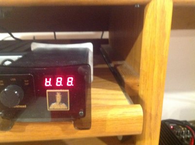

1) First off, the DAC display shows 888, but the first 8 has no bar ontop.  Hoping this is not indicative of any problems.

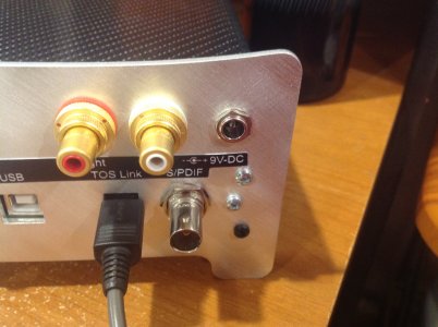

2) After playing with for awhile, I noticed the toslink cable snaps firmly into the denon but is unable to snap into the back of DAC as the aluminum faceplate hole is too narrow and the cable housing hits the aluminum instead of seating.

Please do not, for ANY REASON remove the back panel. Please read the manual, we have tried to be VERY CLEAR that the DAC is not to be opened.
If the DAC does not have a data stream to lock onto, it will not have a value to display. Therefore on startup with nothing connected, it will fill the display with random data. It is nothing to be concerned about.
Your TOSLINK cable end is indeed too big to work. We have used a variety of different cables from different makers without any issue.

Be careful when buying toslink cables for use with this dac.  Make sure the ends are narrow.  I went out to buy a new one today, and of the two i looked at, one was too large.

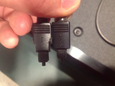

Could you post a picture of the Toslink cable end showing what is keeping it from mating with the DAC?  This will help the rest of us from having the same problem.

Grainger, picture is in my first post.  Look at it magnified. It clearly shows the ends of my wider toslink cable hitting the aluminum backplate, preventing it from seating.  If you need a better pic, pm me with your email.
This is not a big deal, and you can find toslinks that fit fine, but just a helpful comment.
Attached here is a copy of my first cable that i tried to cut away to fit into the aluminum recess.   It did, but either i caused a problem in modifying it, or it was already faulty.  It was an old cable.

That picture above makes it clear.  Thanks!
