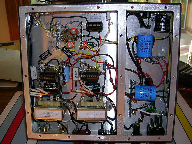

Having built two S.E.X amps, one with the C4S,  MQ iron and cap upgrade, and the other one  just "lean and mean" and very basic  (I skipped the headdphone output and stayed with the stock output iron and plate chokes)  I decided it was about time to try some "Alternative SeX"...   This time, with a different PSU design, 13EM7s in place of 6DN7s, and using MQ BCP-15 plate chokes and EXO-45 output trannies. The power trannie is a toriodal Trafomatic 250-0002, with 190VAC @ 200 mA (actually closer to 215 VAC) and 26VAC @ 700 mA.  The volume control is a 23 step 100K stereo step attenuator, from Hong Kong, and bought through the e-place.  The chassis is a Hammond 12X 10 inch,  black powder coated steel.
The 13EM7 filaments are connected in series, with a 0.1 uF film cap across the 26VAC, and another connected from the junction between the two filaments to ground.
PSU is full wave four diode bridge using MR4100s, and a CLCRC filter.
The sonic results are surprisingly good, very good sound quality and absolutely NO hum, ripple, buzz or background noise, to the point that I thought that it wasn't working properly, on initial power up and test, until I started playing music through it.  The toroiral power trannie is very effectively self-shielding, and with  no magnetic field coupling into the open-framed MQ iron.

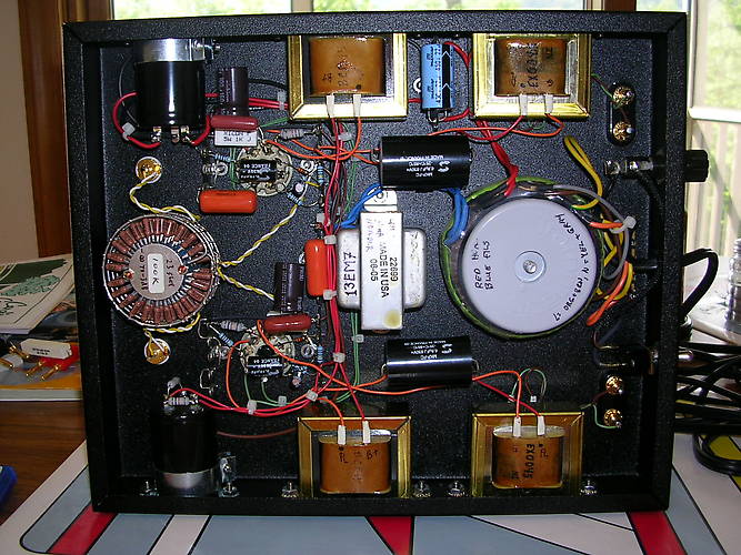

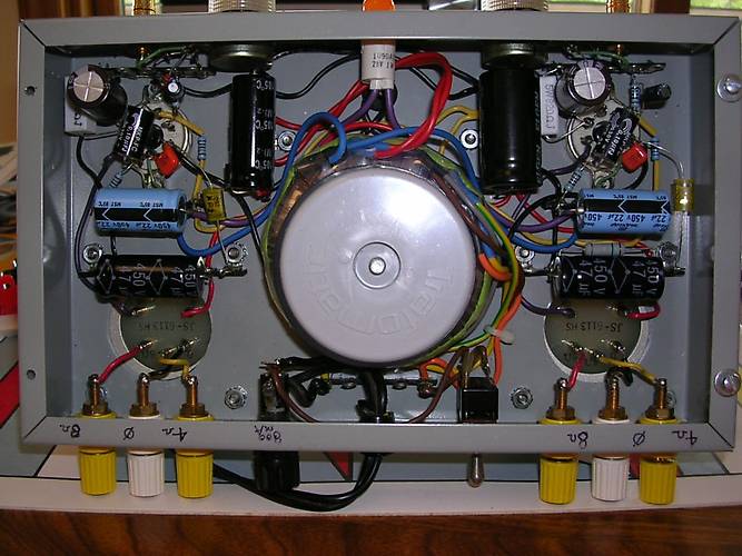

and under the chassis:
(https://forum.bottlehead.com/proxy.php?request=http%3A%2F%2Fpictures.insulators.info%2Fpictures%2F99%2F249740919.jpg&hash=4a417274227d64d479d8e07d0b32e29d8bc17e3c)

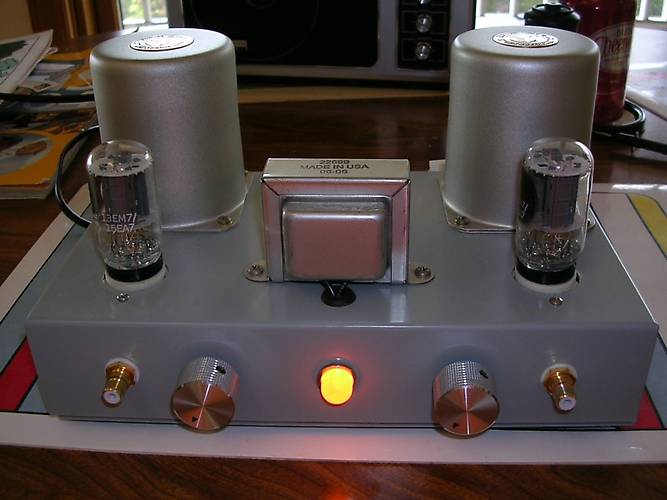

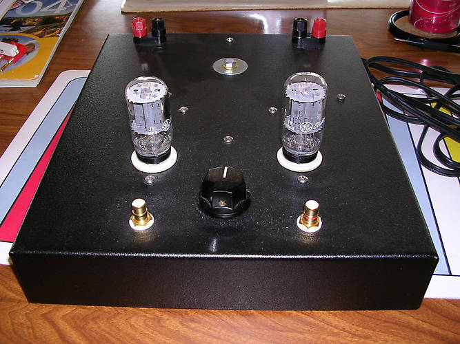

I also ended up building up a series-feed version of this design using some  James 5K OPTs, and fit it all into a 10X 6 X 2 steel chassis.     The rest of the circuitry is identical to thos one, except that the fancy step attenuator was replaced with two 100K volume controls - though I did since then, buy two 100K mono step attenuators to go in this one, some day (if they don't end up in yet another future amp build).
(https://forum.bottlehead.com/proxy.php?request=http%3A%2F%2Fpictures.insulators.info%2Fpictures%2F60%2F280096201.jpg&hash=c2e7447b89994f78072ed99e0ad6f2628eba81d3).
(https://forum.bottlehead.com/proxy.php?request=http%3A%2F%2Fpictures.insulators.info%2Fpictures%2F60%2F280096007.jpg&hash=1bf9bf0d3a57acd341949026bb28bf74788e3fc2)

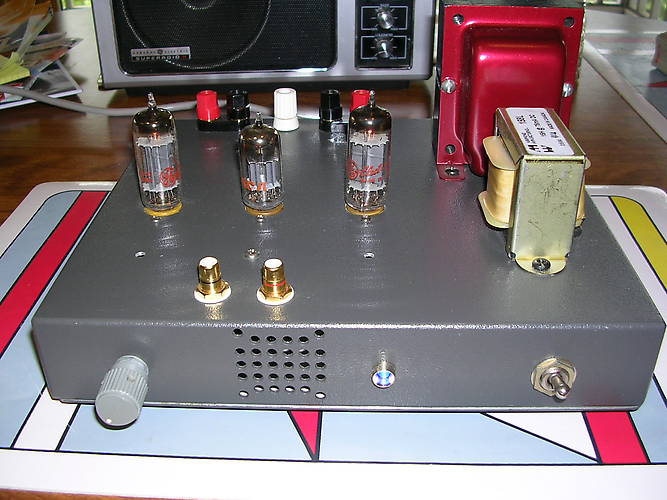

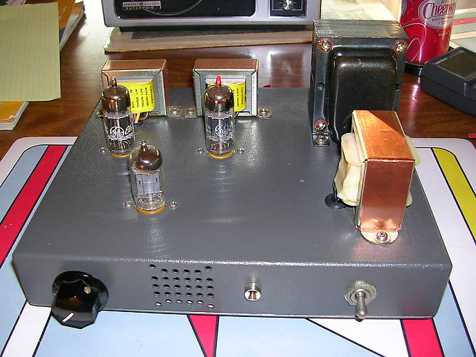

One may wonder what I did with the Speco OPTs and plate chokes from the upgraded SEX amp. Well, I never let anything go to waste, and came up with another parallel feed SET, this time using 12B4As, in a mutant edition of Jef Larson's "Abraxas" SET design.  The filaments are fed with 12.6VDC, and the HV PSU uses the standard two rectifier full wave voltage doubler. The power trannie was salvaged from a junker Heathkit audio generator carcass which I got on the freebie table at a swapmeet. Free is always good!
I shall now save myself and y'all another two thousand words:
(https://forum.bottlehead.com/proxy.php?request=http%3A%2F%2Fpictures.insulators.info%2Fpictures%2F04%2F252074227.jpg&hash=a84d5f0cd752cfb18b8a167cab6418a2f27aeb2b)

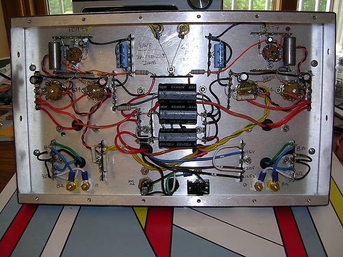

and a peek inside:
(https://forum.bottlehead.com/proxy.php?request=http%3A%2F%2Fpictures.insulators.info%2Fpictures%2F04%2F252074715.jpg&hash=6c53e257d33274436fddca317e9e145307205038)
Power output is approx 1 WPC, and sounds very nice!

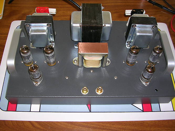

This design has since led to the creation of  a "fraternal twin", which uses 6S4As instead of 12B4as, and it also uses some leftover Speco OPTs and BH plate chokes.   I managed to fit the OPTs and plate chokes under the chassis this time, for a cleaner looking  top deck. I thought I had an under the deck photo, but I couldn't find it in my files...
(https://forum.bottlehead.com/proxy.php?request=http%3A%2F%2Fpictures.insulators.info%2Fpictures%2F04%2F252070601.jpg&hash=3a3a00533c04b7525d8fd9610333b702ed3c715a)
The chassis were leftover and scrapped prototypes from my previous employer, aluminum with a nice gray powder coating.   I ended up with several of these chassis, and have built other SE and PP amps into them.  Size is 9.5 X 10 X 1.5 inches, the smaller separate compartment was originally intended for a small 5V, 3A SMPS.
