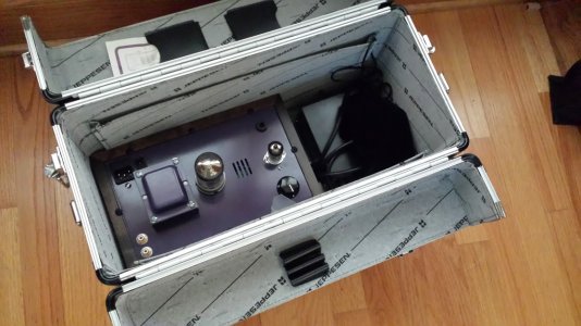

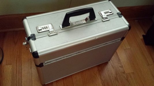

Offline krikor
    • Posts: 12
Reply #5 on: April 02, 2015, 03:23:36 AM
My company was throwing out this case several years ago, so I picked it from the garbage since it sized well for hauling vinyl. The Crack also snuggly fits inside with room for a small DAC, tubes, etc. I used it for a recent head-fi meet. But probably not all that cheap is purchased new.
    • Posts: 9745
Reply #6 on: April 02, 2015, 05:12:12 AM
Actually you can on occasion pick up cheap but quite functional aluminum carrying cases like that at Lowes or Home Depot - or at least I have in the past. I bought three for carrying headphones, tools, small gear, etc. to shows. They have held up pretty well over the years.
