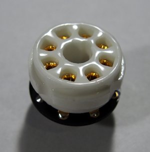

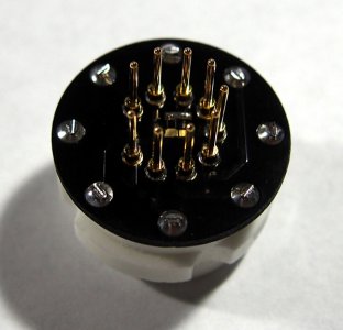

This unit uses a small, round, custom pc board into which a ceramic octal socket and the 9 pins are soldered – no messy wires to capacitive couple the AC to the grid.  I picked one up and it works beautifully.   My Crack was dead silent before and is dead silent now.  The adapter is also about ¼” shorter than the Chinese units I’ve tried.
The pc board has two pairs of solder bridging pads on the bottom which allow some configuration changes.  Bridge one pad and the 4 pin of the 12AU7 side is connected to the 8 heater pin on the octal with 5 open (pin 9 on the 12AU7 side is connected to the 7 heater pin on the octal).  Bridge the other and the 5 pin connects to the 8 on the octal, with 4 open.  Of course, you can also bridge both. The adapter comes in three pre-soldered versions but is very easy to resolder to any of the configurations.

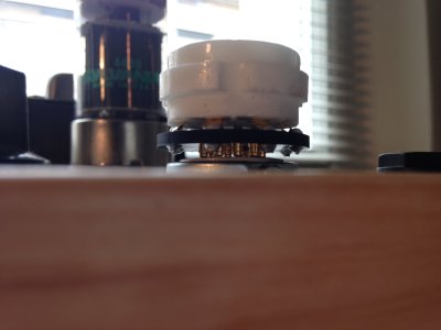

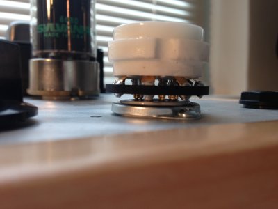

The only downside on the Crack (for me) is that there is some space between the socket and the board, exposing the octal connections to the pc board – not good with grandchildren running around the place.  It was designed for an amp where the original 9 pin socket lies well beneath the top plate.  Since on the Crack it sits above, I filled the space between the socket and pc board with Sugru.  One could use electrical tape, silicone, Sugru or any non-conductive material.

Hi guys - I have a few 6SN7s so I picked up one of these adapters so that further down the line I could perhaps try them out in the Crack.  Although I'm a bit worried reading PB's post that using such adapters in certain applications could damage things.
Anyway, I received it today - and it's a nicely made little device!  As the earlier posts mention, when in the amp's socket the area between the adapter's ceramic socket and the board it is mounted on is exposed so needs covering, so I'll look into that.  The solder points on the bottom of the board are also still visible, and while unlikely to touch them it seems like they should be covered too just to be safe.
I was a little worried at first that the solder points on the underside of the board come quite close to the metal retainer ring on the Crack's tube socket.  There's a couple of mm of clearance and I don't believe they could come into contact - but I was wondering if that should be covered with something non-conductive too.

I've been using one of these for several months with no problems concerning the bottom solder points.  I did fill the area between the PCB and the ceramic socket with Sugru and it has eliminated the exposure issue.
