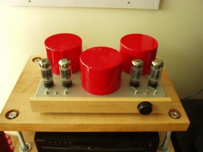

Painting the transfomer covers red made everything sound better.
