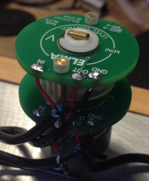

So I'm at the top of page 25 on the third step
( ) Attach the red wire at the free end of the
cable to the center terminal of the lower set
of terminals ( that is, closest to the chassis
plate) on the volume potentiometer. Solder
this connection
This is the right output of the volume control correct?
And the seventh step
( ) Attach the red wire of the 3/4” end to the lower terminal of the potentiometer that is nearest the
headphone jack. Solder this connection.
This is the right input of the volume control correct?
Reply #1 on: April 04, 2015, 10:26:59 AM
Sounds right to me, just make sure you keep the shield connections the same, i.e. shield from both cables join together and terminate at point 13 & 23.
Offline sbelyo
    • Posts: 117
Reply #2 on: April 04, 2015, 02:57:38 PM
got it...  i had to read it a few times to make sure
Offline sbelyo
    • Posts: 117
Reply #3 on: April 12, 2015, 02:56:04 PM
got the right wired up no problem.  The length of wire mentioned in the directions will work just fine.  No need to adjust.
Offline sbelyo
    • Posts: 117
Reply #4 on: April 26, 2015, 02:17:49 PM
got the left wired up.  I would add 1/2" to the lengths of wire for the first and fifth step on page 26.  Since the goldpoint control is taller you might need the extra bit of length.
Offline sbelyo
    • Posts: 117
Reply #5 on: May 21, 2015, 03:32:42 PM
Here's a pic
