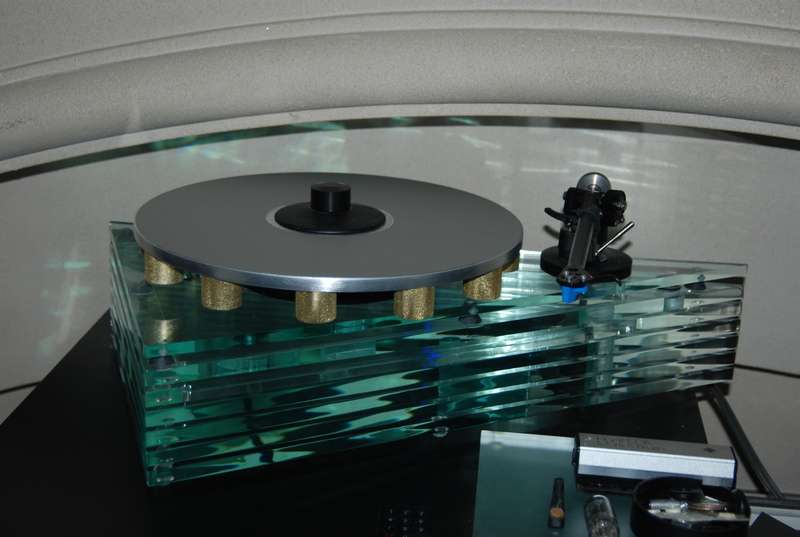

DIY potential is always something to think about.  In my case, I ended up getting a used Music Hall MMF-5 locally, and I lived with it for about 6 months.  I got the urge to upgrade, but instead of heading out to buy a new turntable, I decided to just do a rebuild.
(https://forum.bottlehead.com/proxy.php?request=http%3A%2F%2Fimg4.imageshack.us%2Fimg4%2F9843%2Fdsc0050ud.jpg&hash=0505919b5d0076401758d784826e38fd1afe725c)
It started with a 3 layer acrylic plinth and all the original parts.  From there I added an acrylic platter, then an RB-300, then a Rega Super Elys cart. etc. etc.
Most recently, I added a Speedbox, several more layers of acrylic, and custom made my own 3/8" aluminum platter with brass flywheel weights.  The platter as it is now costs more than I paid for the used table, oh well...
If you get a Project table, doing stuff like this is not extremely challenging.
Offline tsingle999
    • Posts: 275
Reply #3 on: June 04, 2010, 05:08:22 PM
Wow Nice job Paul! Doesnt look anything like my mmf5! I too picked one up locally. It is a nice table. I have a speedbox but with the early version of the mm5 I have to cut the power cord out and add an adapter which  I have bought. Did you have to do it this way too? Any tips would be appreciated.

I ended up rewiring the wire leaving the motor to a male XLR, then I have the motor run cap, power switch, and power entry module housed in an external box.  The Speedbox sits under that, and I desoldered the factory connector and installed my own to feed the motor control box.  I don't think the Speedbox controller has quite the right male plug for any Music Hall tables, but that's the only aspect of it that isn't matching IMO.
