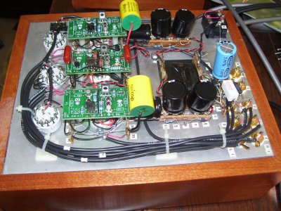

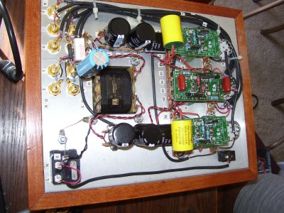

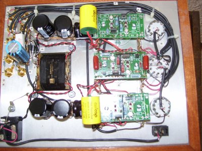

How does the center board in your FP-III look?  Has it turned brown, or is it still about as green as the other two?  Does it have MJE-350's, or MJE-5731A's (5731A's will look bigger than the 350's).
Offline rayrad
    • Posts: 13
Reply #6 on: April 16, 2015, 12:39:24 PM
Thanks for your quick and thoughtful response
The centerboard has the same green look as the other two. No apparent anomalies.
Looking on the parts list it indicates thee are 2 ea MJE340's and 4 ea MJE350's; that accounts for all the MJE's
Everything looks normal on the underside
See attached photos
Raymond Smith
    • Posts: 20345
Reply #7 on: April 16, 2015, 06:01:32 PM
The center part of your center green board shows the cooking that can accumulate over a long life on the E-FPIII.  We tweaked things a bit eventually, using a fatter transistor that was much happier to deal with the heat (even though the MJE-350 is "rated" to do what we wanted it to).
