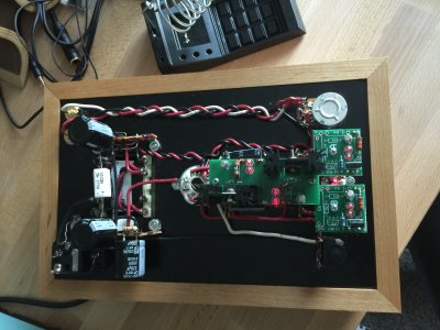

Hi all,
After resolving a few issues with my Crack + Speedball build, it worked well for several months. This week I suddenly started experiencing loud popping in the right channel after the unit has been on for ~10 to 20 minutes. It starts as a soft rustling that builds in volume until it finally discharges with a loud "pop," and then goes quiet. Again, I only hear this distortion in the right channel, including the building static sounds. So far I have tried swapping both tubes, disconnecting the source, and tightening the screws that hold everything to the plate. Are there any other suggestions about what to do next?
Karl
« Last Edit: June 23, 2015, 11:06:50 AM by Caucasian Blackplate »
Reply #1 on: April 12, 2015, 06:32:06 AM
Reheat your solder joints, there's likely a loose one.
Offline squirreldude
    • Posts: 25
Reply #2 on: April 15, 2015, 01:07:10 PM
Paul, I reheated the solder joints and I'm still getting the pop after running for a few minutes. I can't seem to make it pop by tapping on the wood or the plate, but it will continue to pop every 10-15 minutes if I keep the amp on.

I sent the amp to Paul and he wasn't unable to reproduce the popping symptoms. It behaved perfectly fine for him during the week-long visit and we began to suspect interference at my house. However, when I got the amp back in the mail this week, I discovered that the right channel is now totally dead! I swapped tubes, sources, and headphones, but I believe the problem is in the amp. I am including my voltage checks below, since some of them turned out way off from the expected range.

Reply #12 on: June 04, 2015, 05:20:43 PM
Hello Karl,
So sorry to hear of these issues.  The voltages indicate that one half of the 12AU7 isn't conducting.  This can happen from shipping damage to the 12AU7, a bad solder joint between A4 and A5, damage to one LED, or a tube socket issue.
We can get the amp back in the shop to sort this out for you if the issue is not immediately obvious and easily resolved.

Reply #13 on: June 05, 2015, 12:55:27 AM
Thanks for the ideas, Paul. I'll give it a go after work today, but what exactly is a tube socket issue? Should I be looking for something obvious like a disconnected pin, or should I do resistance checks across the socket somehow? All I can think of is simple visual inspection.
Reply #14 on: June 05, 2015, 03:49:36 AM
If you wiggle the 9 pin tube and things suddenly are OK, that might point to an issue with the tube socket.
