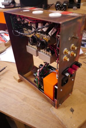

ps - i love my stereomour - i made a special copper chassis for it being a metalworker - it sounds great, and makes me smile when i listen to music.  : )
(https://forum.bottlehead.com/proxy.php?request=http%3A%2F%2Foneorangedot.com%2Fwp-content%2Fuploads%2F2015%2F04%2FP1360193.jpg&hash=ebdc08504c05a031d01343cd31429d5ad71b2bec)
