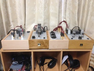

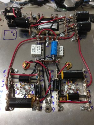

I finished up my Reduction the other day, and finally had some time to sit and listen to it.  It was sounding great for about 3 songs, then the right channel cut out and just started humming.  All the LEDs were still lit, so I reflowed a few solder joints after the socket, rechecked the voltages, and fired her back up.  Happy to report that it's still going strong after a good hour or so of listening.  It's a very nice step up from the cheap SS phono stage I had been using.  Integration comes next weekend!
I'm really lazy when it comes to finishing the bases, so I'm sure it'll be bare for another month or so.  Too busy listening!  :)
