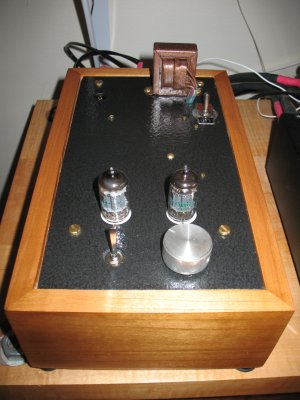

Thanks to Paul and Paul for the suggestions the project is finished and playing nicely.
I rooted around in my misc. wire wound stash and came up with just one under 10 Ohm resistor, a 1.2 Ohm 5 Watt Mills which made the filament voltage exactly 6.29 V! I may buy a lottery ticket.
The $5 dollar Alps Radio Shack pot now has the 100K attenuation shunted to ground. Full listening volume is at 11 O'clock and stone cold quiet. I took the voltage divider ground from the pot, instead going direct to the star. I wonder if that has anything to do with the quietness?
Tubes are JAN 6189W Sylvanias from 1984.
Simple design and good parts equals great sound. I started DIY'ng with the Foreplay and now, 15 years later, here it is again. Cool.

Reply #1 on: May 24, 2015, 04:02:17 AM
Nice work.  Interesting, the Foreplay is a very simple and clean circuit that was only slightly modified through three iterations.
BTW, those are the same tubes I settled on for mine.
